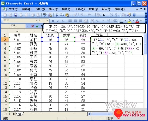

  在Excel中把成绩录入完成,然后在表头行的最后边再添加上一个“等级”列。在F2单元格中输入:=CONCATENATE(IF(C2>=80,"A",IF(C2>=60,"B","C")),IF(D2>=80,"A",IF(D2>=60,"B","C")),IF(E2>=80,"A",IF(E2>=60,"B","C"))),然后把鼠标指针指向F2单元格的右下角,等鼠标指针变成黑色十字加号时,按住左键向右拖动到这列单元格的最后放手。(如图1)
  也可以在F2单元格中输入:=IF(C2>=80,"A",IF(C2>=60,"B","C"));IF(D2>=80,"A",IF(D2>=60,"B","C"));IF(E2>=80,"A",IF(E2>=60,"B","C")),然后把鼠标指针指向F2单元格的右下角,等鼠标指针变成黑色十字加号时,按住左键向右拖动到这列单元格的最后放手。(如图2和图3)

  而本例中的公式IF(C2>=80,"A",IF(C2>=60,"B","C"))意思是如果C2单元格中的语文分数大于或等于80分,则在F2单元格中显示字母A,而如果小于80分则再重新判断是否大于等于60分,如果大于或等于60分则在F2单元格中显示字母B,而如果小于60分则显示字母C。
  CONCATENATE是将若干个文字项合并至一个文字项中的函数。其语法格式是:CONCATENATE(text1,text2……)。而;是将多个单元格字符串连接成一个字符串的函数。其语法格式是:numb1;numb2;……。这里text1和numb1是指IF(C2>=80,"A",IF(C2>=60,"B","C")),即语文这列成绩的等级;text2和numb2是指IF(D2>=80,"A",IF(D2>=60,"B","C")),即数学这列成绩的等级;text3和numb3是指IF(E2>=80,"A",IF(E2>=60,"B","C")),即英语这列成绩的等级
