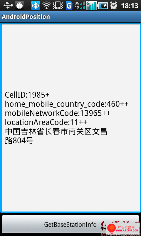

6 图片看一下效果吧。
7 另外在提交数据到Google Gears的时候,格式如下
发送到Google的数据格式:
02-24 18:08:20.550: E/Location send(12892): {“address_language”:”zh_CN”,”host”:”maps.google.com”,”radio_type”:”cdma”,”home_mobile_country_code”:”460″,”home_mobile_network_code”:”13965″,”cell_towers”:[{"mobile_network_code":"13965","location_area_code":11,"cell_id":1985,"age":0,"mobile_country_code":"460"}],”request_address”:true,”version”:”1.1.0″}
接收到Google的数据格式:
02-24 18:08:22.975: E/Locaiton receive(12892): {“location”:{“latitude”:43.8595097,”longitude”:125.3355736,”address”:{“country”:”中国”,”country_code”:”CN”,”region”:”吉林省”,”city”:”长春市”,”street”:”文昌路”,”street_number”:”"},”accuracy”:1815.0},”access_token”:”2:_Kpk9mOFMgyWgLai:8iWlDpBYZsp4_VxO”}
