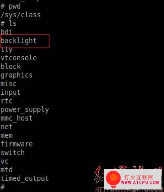

然后重新编译下会生成backlight.o文件,并且在sysfs中会生成我们的backlight class

很简单,这里只是用了class_create函数在sys/class下创建了backlight文件夹,然后是
backlight_class->dev_attrs = bl_device_attributes;
在backlight class中创建了一系列的文件系统,

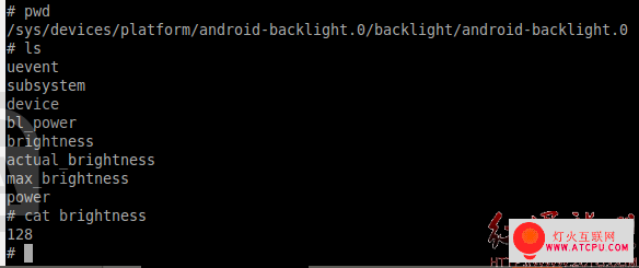

ok,我们来看下我们自己写的驱动,在backlight文件夹下新建一个文件叫  Android-backlight.c,我是参照pwm_bl.c来写的,具体先来看下代码,init函数
[cpp] static int __init Android_backlight_init(void)
    return platform_driver_register(;Android_backlight_driver);
static void __exit Android_backlight_exit(void)
    platform_driver_unregister(;Android_backlight_driver);
module_init(Android_backlight_init);
module_exit(Android_backlight_exit);
使用platform_driver_register注册平台驱动,看下传入的参数:
[cpp] static struct platform_driver Android_backlight_driver = {
    .driver ={
        .name = "Android-backlight",
        .owner = THIS_MODULE,
    .probe  =   Android_backlight_probe,
//  .remove =   ........
//  .suspend
//  .resume
.driver ={
// .suspend
// .resume
这里我偷懒没写remove suspend和resume'回调函数,在移植具体驱动的时候我们都应该写上,特别是suspend和resume函数,来看下我们paltform驱动的device_register是在哪做的,在arch/arm/mach-goldfish/board-goldfish.c
[cpp] struct platform_device Android_backlight_device = {
    .id = 0,
static struct platform_pwm_backlight_data Android_backlight_data = {
    .pwm_id = 0,
    .max_brightness = 255,
    .dft_brightness = 128,
//  .pwm_period_ns = ...;
.id = 0,
.pwm_id = 0,
在init中进行注册:
[cpp] static void __init goldfish_init(void)
    platform_device_register(;goldfish_pdev_bus_device);
    platform_device_register(;Android_light_device);
    platform_device_register(;Android_switch_device);
    platform_device_register(;vh_device);
    platform_device_register(;Android_temperature_device);
    <span style="color:#ff0000;">Android_register_device(;Android_backlight_device, ;Android_backlight_data);</span>
这边Android_backlight_data结构体主要是做一个背光的初始化。
接下来我们看一下probe函数,
[cpp] static int Android_backlight_probe(struct platform_device *pdev)
    //pass the struct from board-goldfish.c ----> init platform data
    struct platform_pwm_backlight_data *data=pdev->dev.platform_data;
    //local private struct
    struct Android_pwm_data *pd;
    //backlight properties struct----> defined in include/linux/backlight.h
    struct backlight_properties props;
    struct backlight_device *bl;    //struct infomation defined in include/linux/backlight.h
    int ret;
    if (!data) {
        dev_err(;pdev->dev, "failed to find platform datan");
        return -EINVAL;
    //----for here we haven't set init pointer function...
    if(data->init)
        ret=data->init(;pdev->dev);
        if(ret<0)
            return ret;
    pd = kzalloc(sizeof(*pd),GFP_KERNEL);
    if(!pd)
        dev_err(;pdev->dev, "no memory for staten");
        ret = -ENOMEM;
        goto err_alloc;
//  pd->period = data->pwm_period_ns;
    pd->notify = data->notify;
    pd->dev = ;pdev->dev;
/*  pd->pwm = pwm_request(data->pwm_id, "backlight");
    if (IS_ERR(pb->pwm)) {
        dev_err(;pdev->dev, "unable to request PWM for backlightn");
        ret = PTR_ERR(pb->pwm);
        goto err_pwm;
    } else
        dev_dbg(;pdev->dev, "got pwm for backlightn");
    memset(;props,0,sizeof(struct backlight_properties));
    bl = backlight_device_register(dev_name(;pdev->dev), ;pdev->dev, pd,;Android_backlight_ops);
    if (IS_ERR(bl)) {
        dev_err(;pdev->dev, "failed to register backlightn");
        ret = PTR_ERR(bl);
//      goto err_bl;
    bl->props.max_brightness = data->max_brightness;
    bl->props.brightness=data->dft_brightness;
    platform_set_drvdata(pdev,bl);
//err_bl:
//  pwm_free(pd->pwm);
//err_pwm:
//  kfree(pb);
err_alloc:
    if (data->exit)
        data->exit(;pdev->dev);
    return ret;

ok,这边就介绍结束了,我们来启动我们的Android模拟器来看下sysfs中backlight下我们自己的节点。
大家可以看到我们自己的device的文件系统,我们cat 出来的brightness就是我们在board-goldfish.c中设置的初始值。
